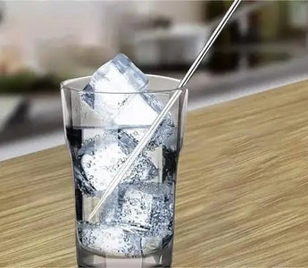

    Ice Point Method:
    Step 1: Fill a glass with ice and add cold water to it. Let it sit for a few minutes to get thoroughly chilled.
    Step 2: Place the thermometer probe in the ice water without touching the sides or bottom of the glass.
    Calibrate Food Thermometer Ice Point Method
    Step 3: The thermometer should read 32°F (0°C). If it does not, adjust the calibration nut or follow the manufacturer’s instructions to make corrections. For bluetooth thermometer without a screen like INT-11P-B, you may need to make adjustment on the app.
