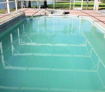

As the weather warms up, the pool becomes a tempting retreat you're eager to dive in. However, that excitement can quickly fade when you slip into your swimsuit, rush to the pool, prepare to take a dip, and find that the water is extremely cloudy and looks like a murky abyss. This is a nightmare for every pool owner - not only is it unsightly, but it can also be hazardous to your health. Fortunately, there’s no need to panic! In this post, we’ll explore the causes of a cloudy pool, and share some effective solutions and preventive tips to clear up your cloudy pool water fast.
What Causes Cloudy Pool Water?
A cloudy pool, whether it’s hazy or milky, is a common issue that signals something isn’t quite right with your pool. Here are several factors that could be contributing to this problem.
