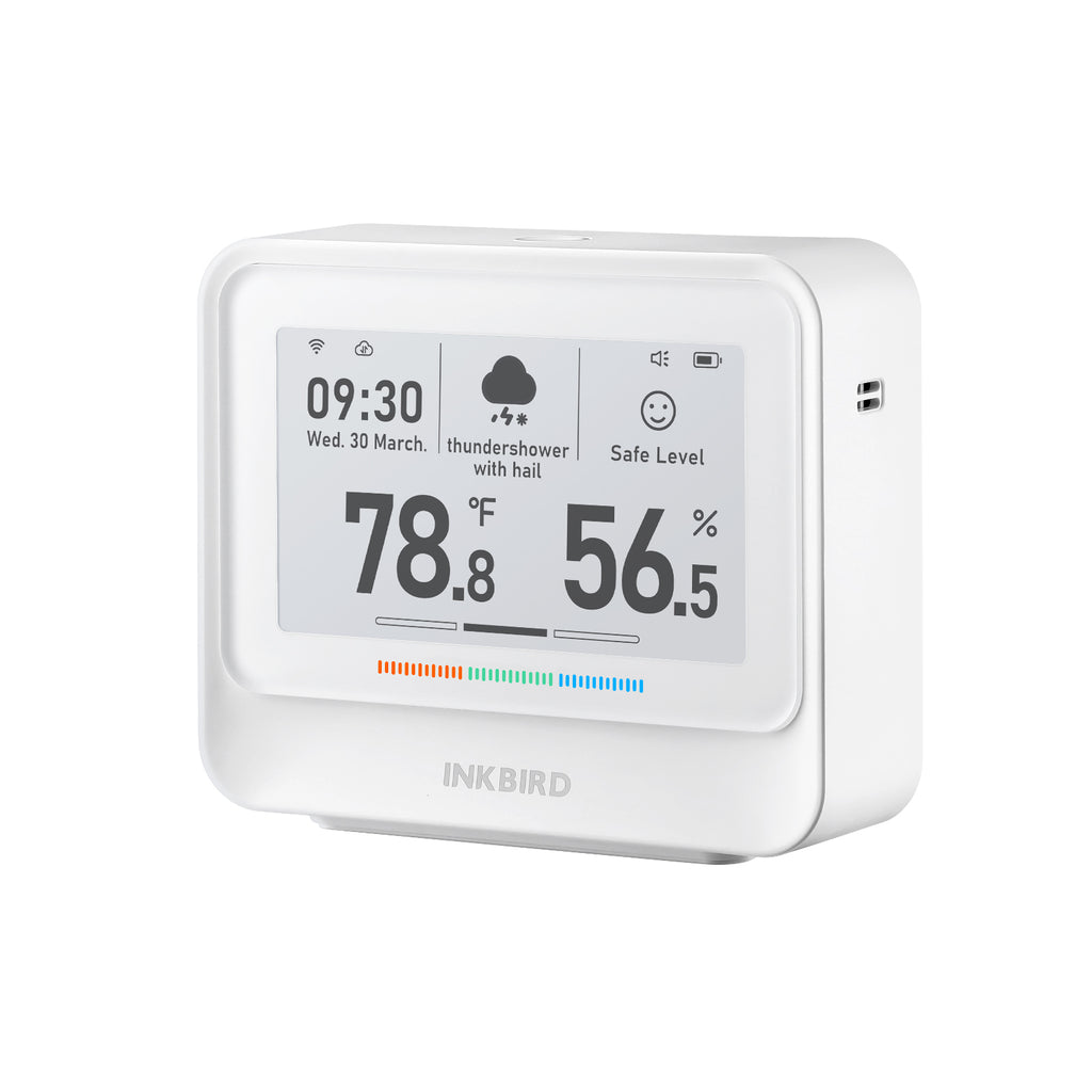

How to Calibrate Digital Hygrometer?
Digital hygrometers are typically simpler to calibrate compared to analog ones. Here’s how to do it step by step:
Material Needed:
- Sealed container such as a glass jar or a resealable plastic bag
- A small bowl or cup
- Salt
- Water
- A digital hygrometer
Step 1: Prepare the calibration environment. Mix two tablespoons of salt with 1 tablespoon of water in a small bowl or cup to create a saturated salt solution, which should be thick and paste-like, not fully dissolved.
Step 2: Seal the device and wait. Place the salt solution and your digital hygrometer into a sealed container, ensuring the hygrometer does not come into contact with the solution and stays dry. Seal them up and leave them away from ventilators, air vents, or direct sunlight for 6-8 hours, preferably 12 hours.
Step 3: Calibrate the digital hygrometer. After the time is up, check if the hygrometer reads 75%. If it doesn’t, note the reading before opening the container, then take out the hygrometer and calibrate it right away. If you can’t find the calibration button, refer to its user manual.
